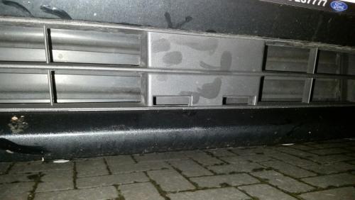

  • The radar is in the lower front grille. Behind the blanked off square section.

Do you have the front radar module fitted; I stand to be corrected but I am fairly sure it is mounted behind the square plastic section on the front grill.
I have checked and I do not have it fitted on my Titanium X however I do get occasionally the red flashing Pre collision warning messages displayed.
Therefore, I presume in my case it’s only using the windscreen camera.
To be honest I thought the front radar is only fitted if you have the Driver Assistance Pack which includes Adaptive Cruise Control with Lane Centring Assist and Stop & Go and is limited to Auto’s.
I didn’t go for the Assistance Pack therefore I assumed the front radar wouldn’t be fitted.

Can someone confirm, is the radar unit mounted directly behind the square flat section on the front bumper shown on the picture below.
If so Its definitely not there on my car.
Alex, its easy to check have you got a radar module mounted there ?

I don’t see anything
I’m sure you’ve googled it too, I’ve tried..getting nowhere.

I take it you have the square section underneath your number plate as shown in the picture.
You can put your hand behind and feel . Is there anything there?
In my case there is nothing there.
If nothing is there then someone needs to confirm where the Radar unit is mounted.
Nothing there.
1 minute ago, Alex.S said:
Nothing there.
Thanks for checking. 👍
