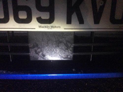

  • I think the front collision system relies on the forward facing camera as much as the radar. Ice and any condensation will definitely affect the performance of the camera and the collision system.
  • The radar is in the lower front grille. Behind the blanked off square section.
  • Direct from the owner's manual : "The system may fail or operate with reduced function during cold and severe weather conditions. Snow, ice, rain, spray and fog can adversely affect the system. Keep t

Pre collision assist is a radar system in the lower front grille and operates up to 50mph.
Active city stop only operates up to 30mph and uses the lidar system on the windscreen.
Perhaps Ford are fitting the radar for pre collision assist but only enable adaptive cruise and fit the buttons for it if you pay for the pack. It’s not the first time that hardware is present for other features but they are just turned off at a software level if you haven’t paid for them.
I think this is correct I have radar sensor but not adaptive cruise only standard version.

Have you got a radar unit fitted in the location discussed and shown in the photo?

No. Front grill directly below reg plate. What I thought was it after looking at the eBay part I now don’t think that’s it. Took a photo anyway...
You can’t tell just by looking at it. They all look the same, Mine looks like that and I have adaptive cruise. You probably need to stick your hand behind there see if you can feel the module or any cables.
Yes, correct I have felt behind and theirs nothing there.
Feels hollow.
in torchlight it looks like there’s a part sat an inch or 2 behind that.

Yes below number plate. I thought this was standard feature across the range .

Just back from the dealership.  They say the plastic square is all I need to clean and I won't feel any wires etc behind it.

It's a square box behind the square panel in the grill below number plate . You can just see it with a connector plugged into  right side.

Yes, that’s what I assumed but apparently Alex.S dealer says “the plastic square is all I need to clean and I won't feel any wires etc behind it:unsure:
Must be a single cable connecting it. Looks and feels like a useless piece of plastic to me..I’m sure it’s cleverer than I’ll ever understand.

I’ve had a right good look at it there with an led torch..still don’t see the connection but I’d say it’s in some kind of metal housing 2 inch behind the grille.  Difficult to scale the photo on eBay.
