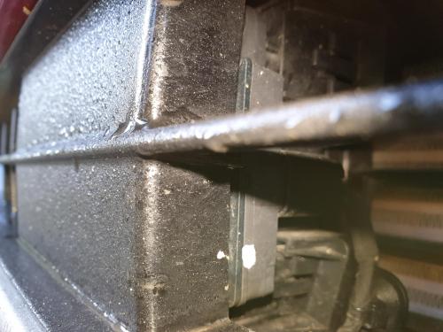

I’ve had a right good look at it there with an led torch..still don’t see the connection but I’d say it’s in some kind of metal housing 2 inch behind the grille.  Difficult to scale the photo on eBay.
Sounds like you havnt got the sensor then.You should see this (attached pix) behind the grill.
Most new models probably have numerous changes made to them once they go into full production not not necessarily to save money
Yep not got it!
Thanks Brian for taking the trouble to post the picture it’s really helpful. 👍
It confirms my suspicions that not all MK4's have this particular front mounted Radar unit and it is not essential as regards the operation of the emergency assist system as proved in my case.
As mentioned before my emergency assist is definitely working as it’s triggered several times alerting me with a large flashing red box and a loud audible beeping sound.
I seem to remember reading in the small print when I was looking for added options for my car that the front mounted radar is included with an option pack which I decided not to go for.
I appreciate that your Vignale comes fully loaded so I would have expected your car to have it fitted as standard.
BTW, I didn't go for the 'Adaptive Cruise Control' & the 'Stop And Go' options.
Also, I took delivery of my Titanium X last December and a friend of mine took delivery of his Titanium in August last year and both of us do not have the front mounted Radar unit.
Thanks again for clearing up the mystery. :smile:
