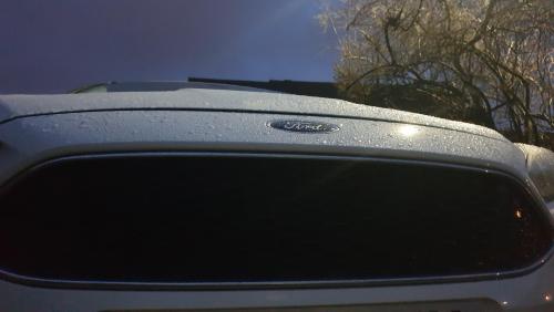

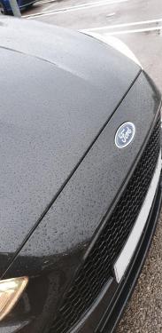

*Here's mine for reference, I've seen one white one recently where the gap was less tight than mine, but overall the few I know and the lads I work with are all very similar.
Mine sticks up more towards the middle and is uneven looking on each side where it turns up towards the windscreen.

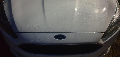

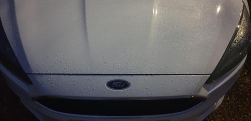

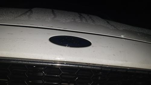

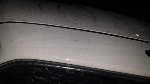

Ok so i finally took the pics. As you can see on first top 2 pics there's a gap and raise towards left center side.
20191221_171819.thumb.jpg.fe0f64e2b5e2f795dcf7bccf7e3b18dc.jpg20191221_171828.thumb.jpg.16300d75eec94efed7cc85ce3d286fe2.jpg20191221_162958.thumb.jpg.aef2049d07bc8d0e63e1a6f774988b8a.jpg20191221_164038.thumb.jpg.f53c213cae0d793a620b5f048500cb77.jpg20191221_164042.thumb.jpg.d718768b489d7a0e7f5e2a2adffe2ec2.jpg20191221_162949.thumb.jpg.b8d7fbd4ed75c1a93ae1088981369fb9.jpg
I see what you mean, its almost as if someone has leant really hard on the edges to close it and bent them slightly. I know another lad who has a bit of a struggle closing his, the catch seems to be really really stiff and really pushed the bonnet up in the middle when you try closing. I'll see if I can see him today and grab a pic to compare.
Does the bonnet line up otherwise with the lights okay?
It's really starting to annoy me though. I wonder how the hell it ended up like that and why and if it's even fixable which if it's not would be fked as i just paid £9k for it 3 weeks ago.
Couple of things to try and establish first, is it the bonnet at fault, or is it the bumper 'nose' that's dropped in the middle? Mine is all damaged inside and had to get the bumper off to repair but got lucky in that it didn't say at all, and the mounting and locator points were still usable. I've had someone slide down the front of the car too which has really bugged the crap out of me (paintwork scratches) but it didn't break the nose which was fortunate.
Metal, if it is the bonnet, can be manipulated so that makes things a bit easier. Plastics break and can be hard to sort as easily at times.
Still waiting on seeing the lad at work but when i do I'll grab a snap still.
