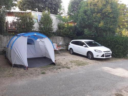

2012 seems very late for a MK2.5, can you post a picture so we can be sure?
MK2.5 is the 16v engine and electro-hydraulic steering.
MK3 is the 8v engine and fully electric steering.

Here's the only pic I have

That's the mk 3.  How different is the cambelt on these @TomsFocus ?  Electric power steering anyway John!
Ps nice tent 😄
Cheers and thanks for confirming mk3, why I thought it was a 2.5 don't know. The tent, cheapy from Decathlon, we did Calais to Blanes, 1 overnight motel and 2 days camping adjacent beach, then Andorra hotel for 1 night, then Beziers, 2 nights camping in Antibes then headed back stopping various places, great fun
Yep, as above that's a Mk3 so has the later 8v engine and fully electric steering.
The cambelt change should be pretty much identical as the belt only goes around one cam on the 16v engine anyway, the second cam is driven by a chain.
