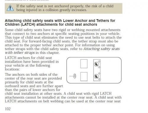

I don't have kids, but this is taken from the 2005 Focus handbook  don't know if it's of help or not!
Yes, you should already have them, pull up the back seat and they should be obvious.
If not fitted then lift the seat bases up and look for blanking plugs.
If the plugs are there then fitting the isofix mounts is pretty straightforward.
