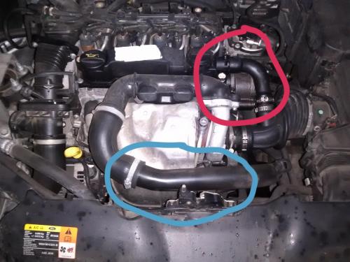

In your first post are you talking about oil from this part

Yes so the image I've circled red that comes off easily and is filled with oil, and the blue circle is the other one now covered in oil towards the left side.
Also is it the oil feed pipe you're saying I need to replace or the oil return pipe?
(At work so found a picture of an identical engine for reference)

I'm no expert on the turbo as I've not changed one myself but I can tell you that one of the fixes for the turbo failures was to fit a new wider oil feed pipe.  I've got a feeling the sump might have been replaced as part of it with a redesigned one, and then regular oil changes recommended (every 6000 miles) to reduce the carbon build up.  Just to be sure, are you running the 110bhp or 90bhp 1.6?  Some of the 90 versions don't have the issue because there's no dpf filter which was the root cause of the problem (the heat from it was cooking the oil hence carbon build up..)
I would hazard a guess the blue circled pipe has a fine crack in it either where you've circled or on its way down past the oil filter. They're prone to cracking and will spray oil everywhere.
