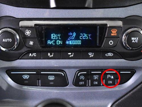

Does your infotainment display change when you activate the parking sensors manually (the button with the P and cone symbol)?

The 'A' button has nothing to do with the parking sensors - it disables the auto start/stop feature of your car until the next ignition cycle.
What is displayed on your infotainment screen when you put the car into reverse now that your rear sensors are working? Can you post a picture of what it displays.
Also, do you have the 'Auto P' button? Can you post a pic of your button configuration underneath your climate controls.
I don't think the 2014 Titanium came with front sensors as standard so the 2 pics will help determine if:
  1. You have factory fitted front sensors that aren't working, or
  2. You have aftermarket front sensors that aren't working, or
  3. You don't have front sensors.
