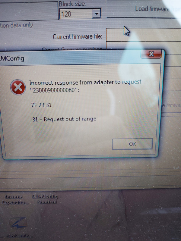

I'm getting a similar error
Somebody with elm config please help
Have you chosen the correct PCM from the dropdown list?
I followed the guide on this forum to the letter... Will try again later, as most information on this subject says it takes over 10 minutes to read the pcm. My computer took 30 seconds
