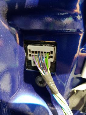

Ok check your mirrors connectors then by removing small speaker cover on door , 🙂 and let know how many pins you have , then we can move to another step
12 out of 14.
i have added some photos
Yes you got the wiring just get the mirrors and switch like a said in my post 👍
23 minutes ago, Wezaa said:
12 out of 14.
this is what 10 and other side is ?
no need to check modules
Sorry yeah. 10 out of 12 not 12 out of 14...
I didn't check the other side.
I will do so tomorrow and post a pic.
Thank you
Thank you.

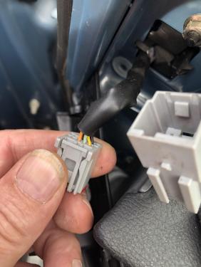

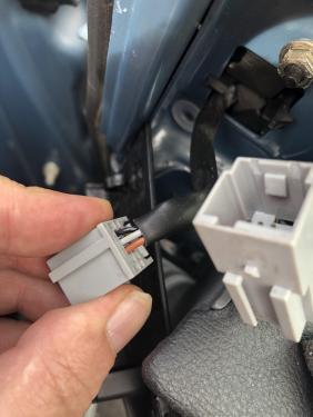

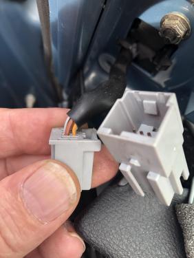

Hi all. Can anybody tell What am I missing? Only 6 wires behind the tweeter  thanks
It not that plug you should be looking at its the other plug that it goes into  should be 7 wires but 8 in the passenger side one
Lol sorry my bad. Good job was thinking I couldn’t have them thanks Tezza
