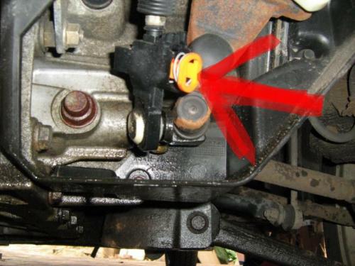

Hello you need a justage..
1.Put the 3 gear on and lift up the car.
2.open the Black Box in the Front of the Transmission.
3.push the Organe Button on the cable, click.
Finish the cable justage is new... Drive again
