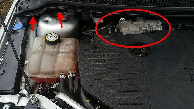

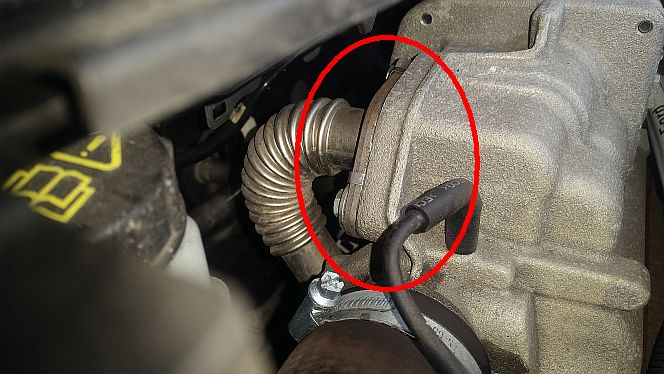

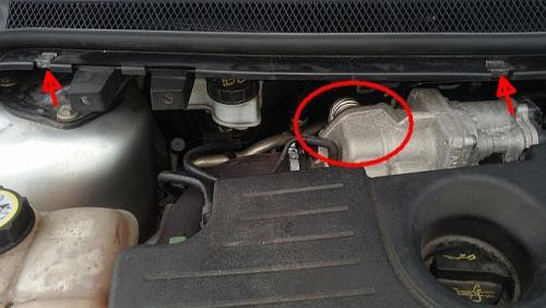

Well Clive AKA Stoney871 sent me the Pic's and guild below, which might be helpful for others with a MK2 Focus.
msg-28494-0-61149900-1401386255_thumb.jp
msg-28494-0-05835700-1401386251_thumb.jp
msg-28494-0-02495400-1401386261_thumb.jp
The plate goes in between the pipe and the EGR body where the third picture is marked.
You loosen the two bolts and slide the plate between the metal gasket and the EGR body itself.
To access the bolts is a bit of a pain but the whole project will take about 30 minutes.
First you need to remove the wiper arms.
Next remove the clips along the front of the scuttle as arrowed in the first and second photos.
There is a rubber seal that sits between the upper and lower scuttle parts which will pull away easily.
Remove the top scuttle panel and you will find bolts underneath holding the lower panel in place.
Undo these and lift the panel off then the bolts on the EGR pipe are much easier to access.

Fitted the egr blanking plate today couldnt get to the part to remove the egr, not started it yet :/ too scared ha, am i right in placing the blanking plate under the the egr on the pipe i showed in a previous post?
Right finally started it, took it for a run, true its more responsive in lower gears and sounds alot smoother but it hasnt removed the power loss so im all out of ideas, i will only know if the poor start continues in the morning and i will update again......possible leaky injectors thats my last theory
you didnt need to take off wipers n scuttle etc.... easily do-able with them in situ... takes around 5 mins...
