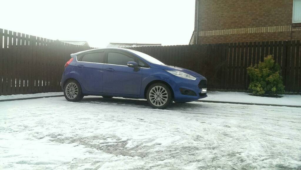

Did u ever correct the spedo or just left it and have u any side pictures thanks mate
There is no need to re calibrate the speedo as it was over reading by 4mph, but with the new tyres it only over reads by 2mph.
IMG 0227[1]
New wheel and tyre with 195 50 16 tyre
IMG 0226[1]
as above
IMG 0225[1]
Old wheel with 195 45 16 tyre
Looks wicked I'm sold on idea now have u got 1 picture of whole car from side view.
