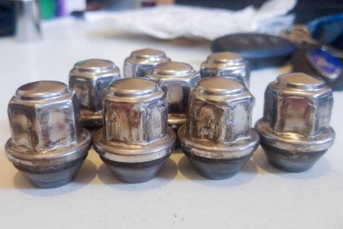

It was just the front nuts that were knackered, so I bought 8 original replacements (£2.84 each)
https://www.micksgarage.com/d/wheel-nuts-and-bolts/products/1869223-9157-55485/febi-bilstein-wheel-nut
Changed them this morning and most of them required hammering on the wrench to get enough grip to loosen them,
Then I had to put the nuts in a vice to get the buggers out of the wrench.
Thought I'd do the job properly and buy a torque wrench, I'll be taking the wheels off more for better cleaning in the future.
https://www.amazon.co.uk/gp/product/B075RCXT2Y
I'll be telling my garage not to use a 12 point impact socket on them, you can see they chew into the soft edges.
I'll only use the 6 sided socket that came with my torque wrench from now on, I had a 12 point socket for my breaker bar which I'm not touching now.
