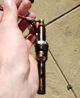

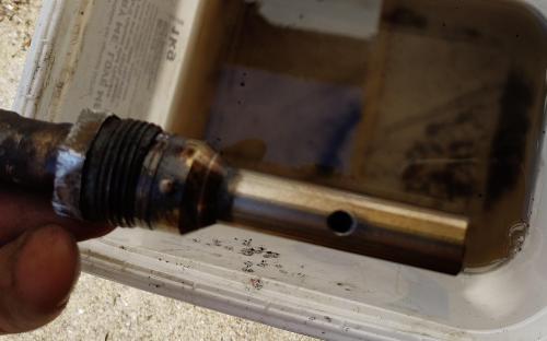

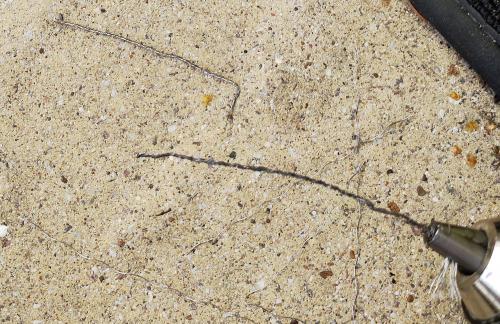

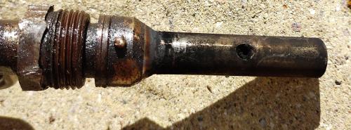

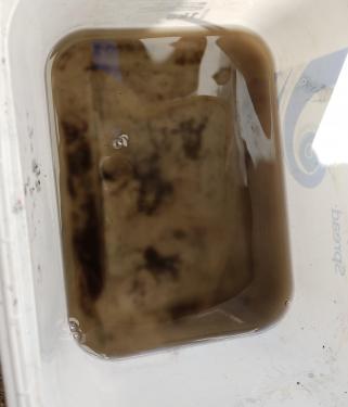

Just for anyone who lands on this thread with similar problems.
Gave up last night after several attempts, tried again finally got the fuel vaporiser off, so it had half a day with WD-40 gave it another good spray this morning too.
Found a video on YouTube where they use a few strands of brake cable and a drill didn't hold much hope but it's worked can now blow through the vaporiser freely.
I found using a screw driver to clear the hole then using petrol to aid cleaning.
Then took a few strands off some bike brake cable put it in the tube barely went a mm in at first went easy with the drill speed in reverse and the cable slowly worked its way up the tube.
Did that a few times with the drill in reverse than normal and flushing with petrol and then blowing down the fuel inlet with some silicone tubing until I could easily blow through the vaporiser.
I'm not sure this will work if it's really heavily soiled / dense but took about 5 - 10 minutes so definitely try it as soon as you get the warning.spacer.png
