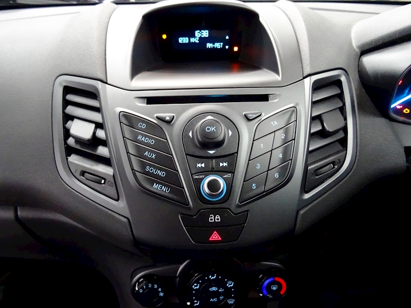

what engine is this?  I have a fiesta Style 1.5tdci econetic. It has stop/start because it is Econetic version. Also has hill start assist, I think that was included as standard on this car. Also has bluetooth but that was a paid for upgrade -  standard radio is basic without Phone button on it on Style(I did not buy the car new myself). No idea about auto wiper activation. My previous 2007 fiesta zetec had auto wipers - to be honest i did not like it, it always seemed a bit tempramental - I would have to keep altering the sensitivity knob - and I did keep my wipers in good order
style radio
