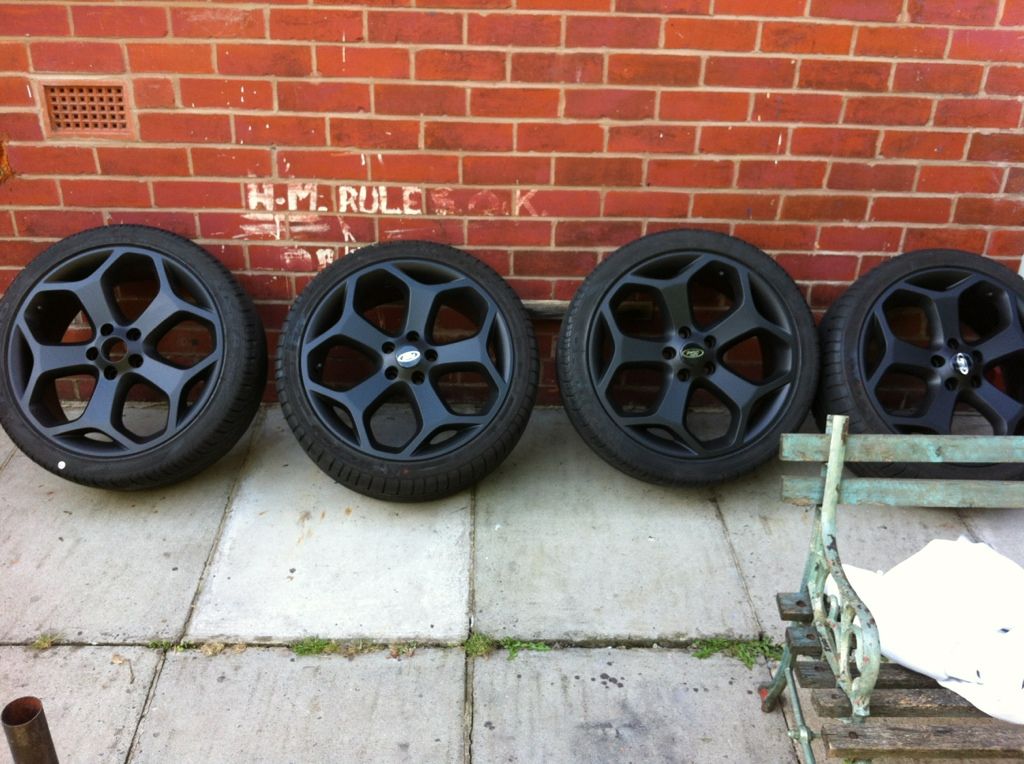

hey guys had a busy morning plasti dipped few bits on my car love how the wheels look few pictures below all comments welcome D.gif

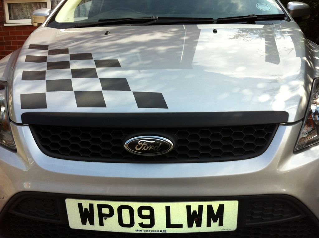

bonnet lip

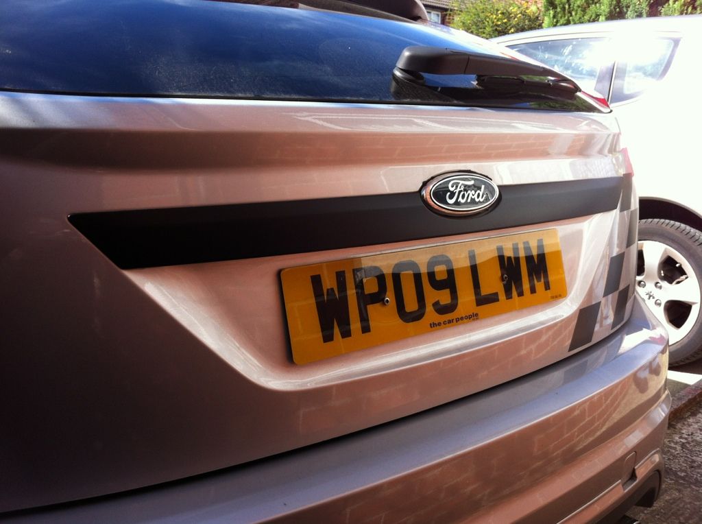

and rear lip
Liking the wheels mate they look quality ;) how much that cost you?
i did 7 coats on the front 2 coats on the back 4 coats on the front and back lips on the car and used 3 cans at £13 a tin so £39 not bad even if it only last few months it will only take a morning to redo um.
That looks gorgeous any chancw you can write up a quick guide for a beginner?
its really easy mate i have never used spray can in my life this stuff does most of the work just start by using playing cards or similer like this
then start by going round the outside of the rim then work you way over the spokes you wanna get like 50%-60% covereage on the first coat then on the second and thrid you wanna cover the bits you missed on the first i did 7 coats i would just say by a tin and have a play it completly comes off so no worries about ruining your alloys.

How easy does it come off? Is it worth just painting them, I don't want to do it then first wash its all gone :/
Not to sure how long it will last but I've seen YouTube videos of them being jet washed and they seem fine
having used the stuff it depends on high wear areas it needs touched up a lot youtube never tells the whole truth its a good product but the u.s doesnt have the crap on the roads we have its great to use during the winter to protect the alloys i use it for protection under the wheel arches it lasts a good while

Id love to do this myself but i don't think id be at all good, did you just spray over the chrome bonnet strip too, no sanding down?
hey patrick thanx yer i just cleaned the chrome strip and then just sparyed the plasti dip straight on. its really easy the stuff ive done is the first time ive ever sparyed anything.
