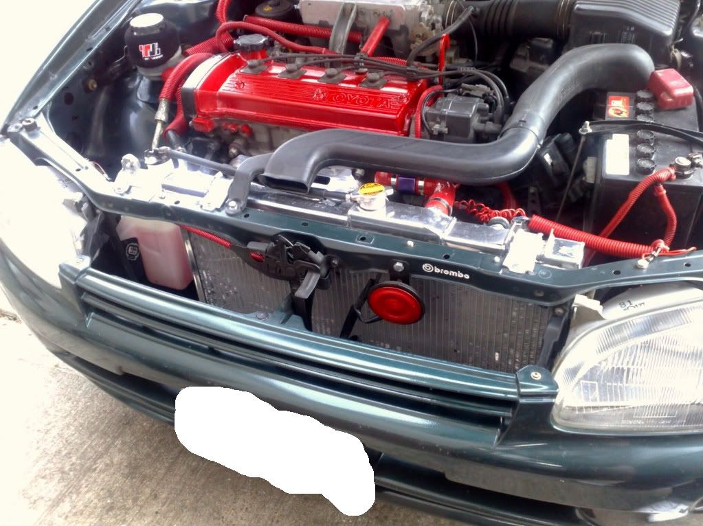

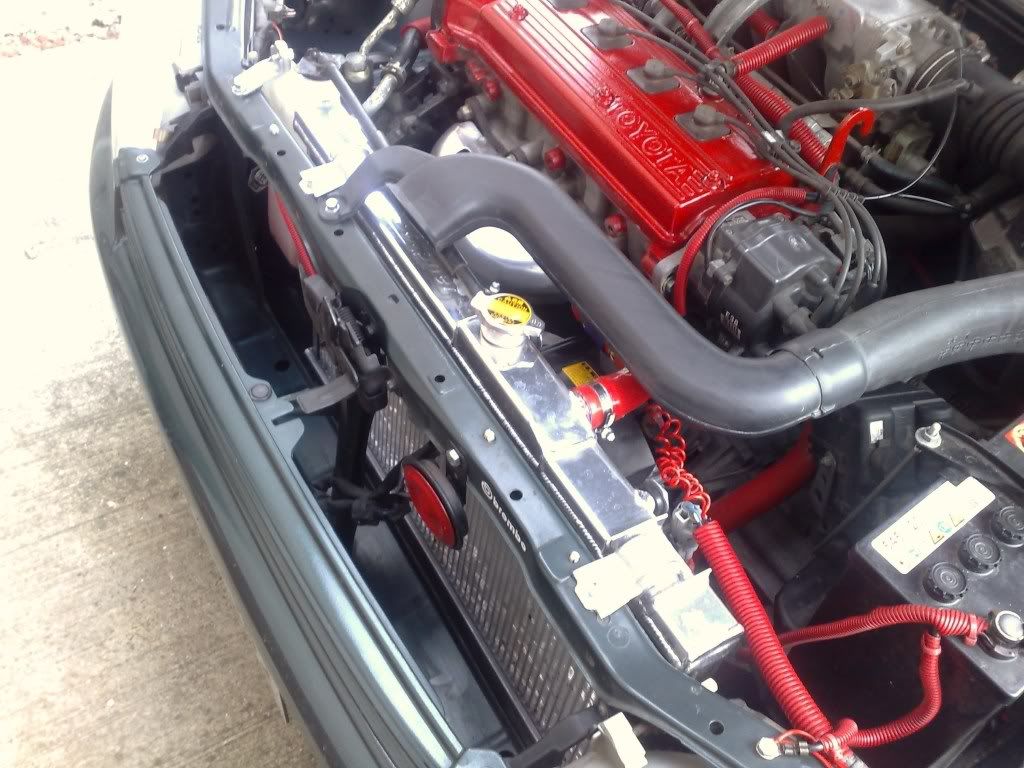

I been watching too much Westcoast Customs and then looking at my Focus on the drive.
I started out the same way lol that show should come with a warning may give you extreme inspiration
I mean look at this, after watching Pimp My Ride for 6 months back in 2005
Now its too much West Coast Customs and Gas Monkey on Discovery Channel
Somebody please climb on my roof and take down the Sky satelite dish lol
