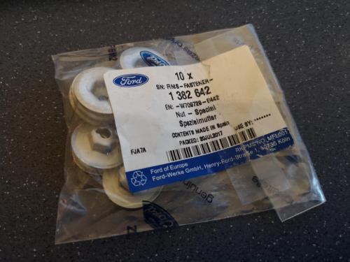

I'd be carful the bit on the car is like a rusty old self tapper (and non replaceable - so you don't want to snap it off)) and the heat shield rots and falls apart   I just cut a bit of steel to make a mega washer hammered it in place with a socket and use the far to expensive new ford clip / nut things to screw gently in place, they take about 4 lb ft before the new ones strip and become bin material
76p each for those nuts/washers last time I bought a bag lol

I bought them from a ford dealer on eBay, I can’t see the listing now. There are bags of 10 for £12 odds! 😱

Received today many thanks very much appreciated 👍😁
