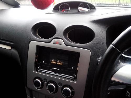

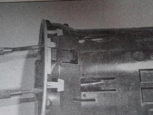

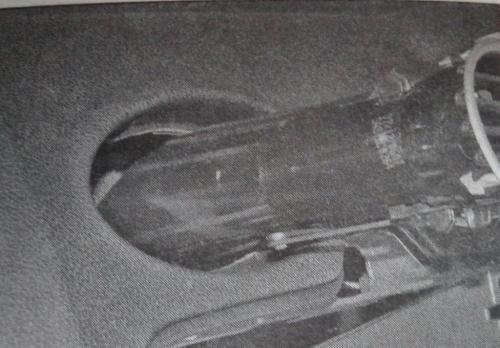

You will need a torch from your phone and two small flat head screwdrivers
To remove the vents Obtain two flat head screwdrivers, Insert them in to the clips inside the vent and lift screwdrivers upwards while pulling out the vent.
All four vents are identical in length and design, reftting just push in and they clip themselves 👍
