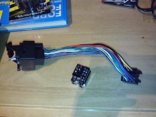

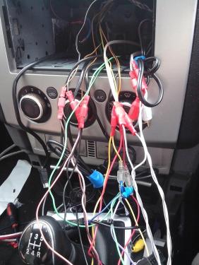

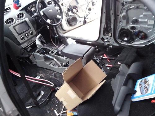

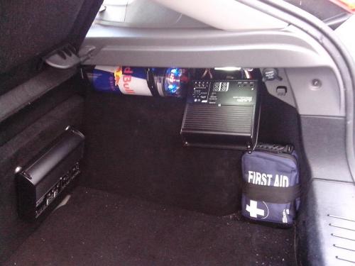

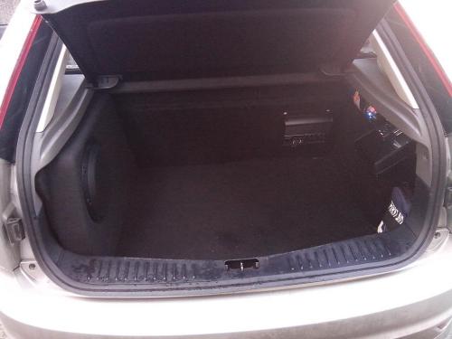

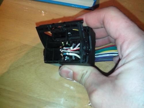

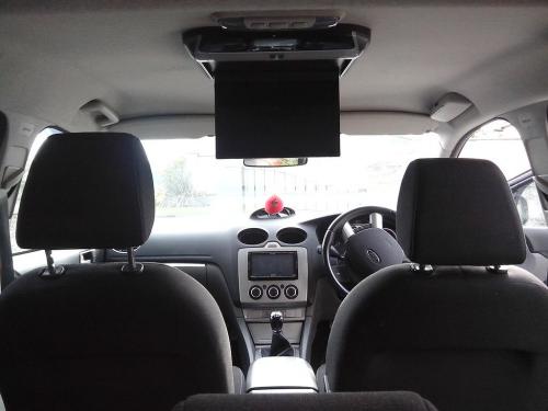

I removed the ISO block completely from my focus mk2.5 when fitting an aftermarket headunit to save space at the rear because I've fitted alot of RCA cables 15 in total for two amps, tv tuner, reverse camera, PlayStation and a 10" screen,
I can tell you that none of the cables leed directly to the parking lights, The interior light feed is linked to the headunit via "The Gem unit"
The GEM general electric management unit is the Can-Bus brain it controls lights and locks and is seperate to the ECU
I used a Haynes manual for reference,
But I've never experienced anything like your describing man.
