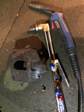

How many folk would say a bleed screw that’s sheared flush with the surface of a 12 year old caliper is not coming out? The attached pic is of a caliper I saved on Friday night. With the right tools anything is possible. In your case, cheaper and less hassle than a new sump too.
