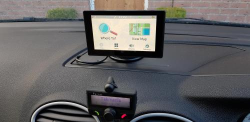

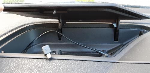

Hi Pete do you have the lift lid on top of your dash ?
I put a aux power supply under obd socket then ran sat nav cable up behind clocks and put a hole inside unit under lid then cable stays in lid out of way and when I want sat nav I lift lid clup sat nav on close lid sat nav has a disk on lid nice and tidy.
cheers
Alan
thats what ive done on mine much easier
I don't have the lid/box on mine- just a plain dash top. The space where the lid would be is flat and slightly recessed, but it doesn't open. Looks like I should be able to drill down from the top and avoid the air vent ducts.
