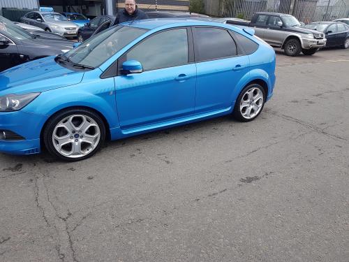

1 previous owner from new full service history 12 month mot and service just dome pick it up Thurs. Pic below not bad drives good better than my 118d 2010 bmw 1 series too heavy and low for me
Also that isn't me in the picture haha
As an added benefit, now that you're a Ford driver you've got a decent chance of being let out at junctions which will probably be a novel experience with you having come from a BMW! :thumbup:
Oh and it's looks tidy in that shade of blue with the body kit.
