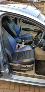

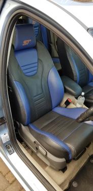

Ok now started on seats and other interior mods,
Has anyone fitted heated seating elements into their seats , I have new seats the wiring is there and switch`s are in now and I am picking up titanium seat bases which have heating in so is it sraight forward to insert them and plug in or do I have to fiddle with them20190413_152328.thumb.jpg.f4d4eeb959d185dbc71686d381f3a51d.jpg20190413_152321.thumb.jpg.f361298a3507a25e9c72461dc069e6d5.jpg
Cheers
Alan

ive done heated seats in my titanium. the seats in the pic should have heating elements in them. i found in the passenger foot well behind a plastic cover is the loom. i had to run wires from behind there to the seats for the switches and then from the fuse location to both seats for power hth

Hi Mate
These are a custom job They didn`t come with heated. but where I go them have got some Titanium base I can take heat element out of and insert into mine just wondering if its a pain in ***** lol.
When I took screen switch`s out of dash I noticed the wires taped up already there
Cheers
Alan

depends on your patients its just a mater of removing the seat cover then
putting in the elements  and rebuillding the seat base
