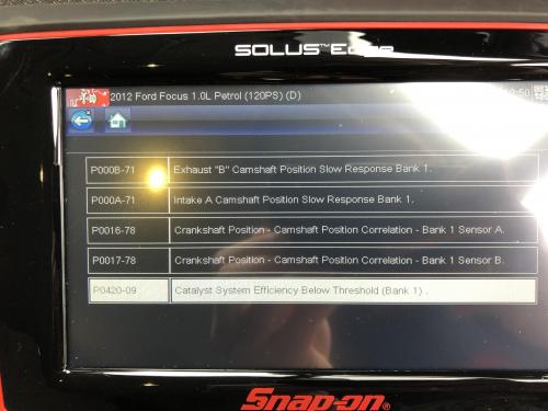

Thanks for your reply. I’ve took to mechanic today and got these codes
Hmm, wasn't expecting a timing issue tbh.  Did the mechanic make any suggestions about a fix?
