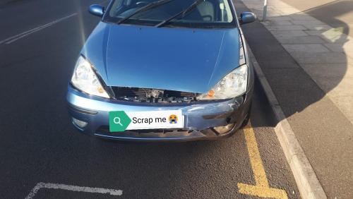

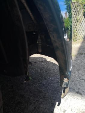

Maybe his car is just f***ed then lol. It did look like this after accident
Thanks anyway

Yeah it does look a little twisted😁

I reckon the front subframe has been pushed back.
Was the car assessed by a garage after the impact?
The car may possibly be a write off.

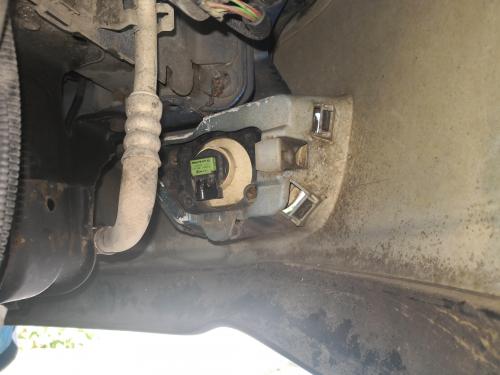

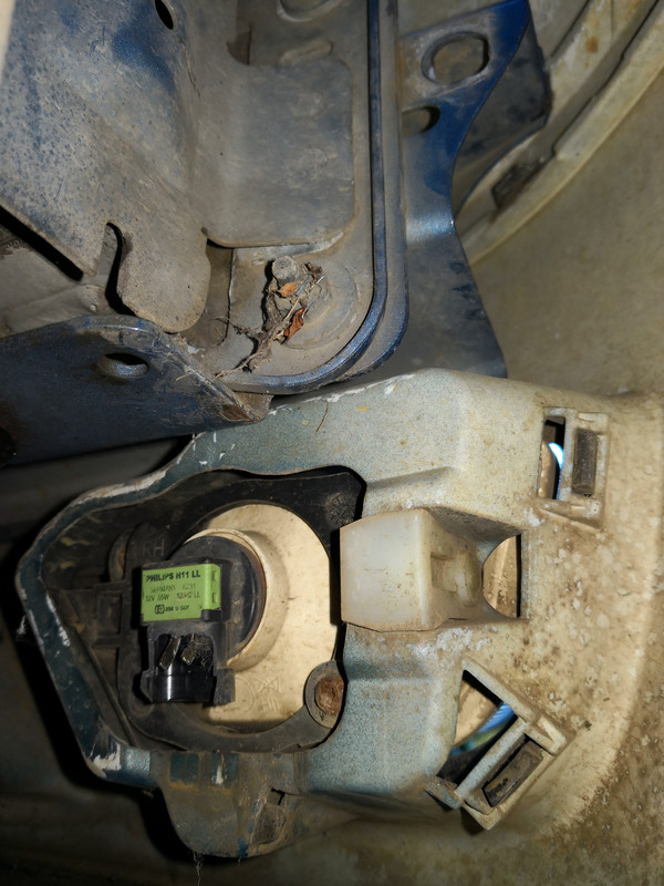

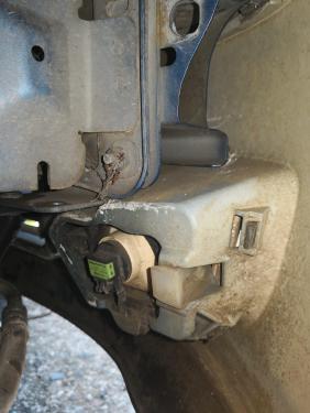

Update: We bought a cheap angle grinder today from screwfix and cut tiny part of the crash bar that was sticking into the fog light. Now the car is back together and hopefully my brother will get a year out of it!
