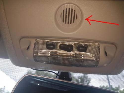

Hi Guys . thank you for help on last post, i am still learning about the car. and my age doesn't help. lol. I am trying to figure out if my car has a bluetooth module  installed. it is pre ford sync 2007. sync on cars came after 2008 as i read it. anyway i notice some thing on interior light fitting . could somebody identify please . see picture. also trying to find colour code . ford class as ''Orange'' but looks more like red metalic. Thank you for any help.
Register for ford etis an put your vin number in a it will give you an as built list of equipment. The colour code can be found on the plare on the drivers door shut pillar, this video will show you its the same on a cmax. You have a different interior to me so im not sure what that is but i suspect maybe cabin temp sensor
