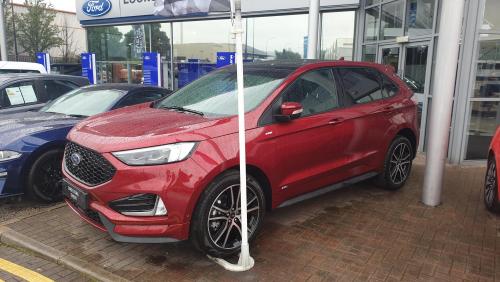

I picked up my new Edge ST-Line on Monday with just 13 miles on the clock.
I took it back Tuesday as it felt like the engine was missing.
Dealer ran it with computer plugged in and the fault is the torque convertor in the gear box
