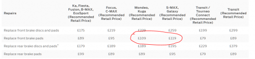

Not done the pads on my Edge yet, but always do pads myself. For the Edge they are around £25 a set for the fronts, so unless it takes them 2 hours to do a 30-40 minute job, I'd personally say that's a bit pricey, but then again dealers always are!
Having a look on the Ford Motorcraft site, for similar size cars they are quoting around £110 to £120 ...
