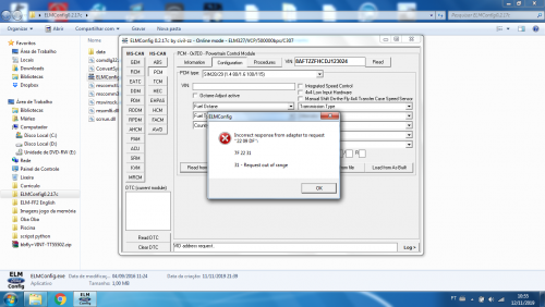

After that I went to ELMConfig (tried in versions 0.2.17c and 0.2.17b) to do the third step, activate in PCM, then when I try to load the PCM appears:
(attachment img1)

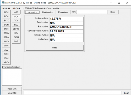

If I go to 'configuration' and try to load PCM it looks like this:
(attachment img2)
