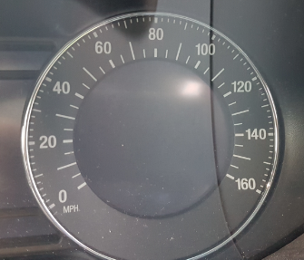

I have a st line Edge, the right hand speedo dial only shows MPH around the edge, is it possible to configure it to KmH?
I know I can get the central digital section to show KmH, but would be handy to get the dial to do the same, if for instance I want the navigation to show in the central display.
any ideas?
The outer ring of the speedo is not configurable unfortunately

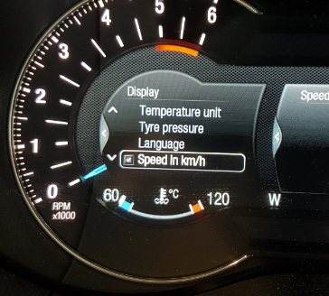

Might be different on an ST-Line but on mine.
LH Steering Wheel Button
Settings
Display
Speed in KMH, OK to select.
H
Mine's the same as Hamster above and that's with Sync2
Cross purposes here, Mac2019 asked if the speedo ring could be reconfigured to KPH,  I don't think that's an option because the numbers aren't LED, they are cut-out of the ring.  If it's possible to configure a ring of KPH numbers to be displayed inside the MPH ring then that's great
Mines a 2016 model (66) with Sync3 and the MPH ring is hard moulded in the cluster ...
if you set enable 'Speed in KPH' in Vehicle->Settings->Display ...
You get a KPH ring in the speedo ...

your 1st photo looks the same as mine, just showing mph printed on the outer ring

... As per my bottom photo then?! So are you sorted now?

Yes , all sorted
