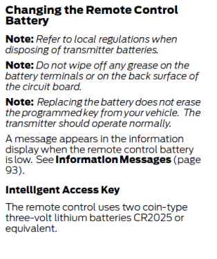

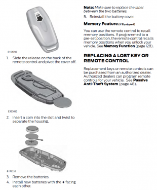

From the owners manual ...
image.thumb.png.50464d81593a076b451050553eb1c1b0.pngimage.thumb.png.8f8f766bfe33eb2f5e9d32bd190950ab.png
... told you it was quite informative!
image.thumb.png.8f8f766bfe33eb2f5e9d32bd190950ab.png image.thumb.png.50464d81593a076b451050553eb1c1b0.png
