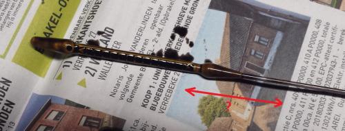

I was happily driving a 1.6 TDCi Mk4 of 2012 but got hit in the rear and insurance declared it total loss. So I now bought a 3-year old / 27.000 km 1.5 TDCi Mk5.
I had a maintenance done by a Ford dealer before starting to drive it. After two weeks I opened the hood in order to check on levels, and I found the oil level as if it was overfilled (see photo). Then this was checked by draining the oil. Volume drained was 3.975 l, while dealer says oil volume to be filled should be 3.85 l, so indeed 125 ml of excessive filling. This should however not be a problem and to my opinion also not result in such an excess on the dipstick. Anyway, there was 3.85 l of oil returned into the engine, and the level on the oil dipstick still shows too high (oil level still above all yellow plastic on the dipstick) . Following the dealer, the dipstick measurement is not correct. I am puzzled here. I always thought that the level read on an oil dipstick was thrustworthy. Anyone else had a similar experience?
Note : oil level testing was always done on a level floor and the engine had not run for several up to even 24 hours.
Sure that I will next time change the oil myself, measure 3.8 l (which is actually what the manual says if oil filter is also replaced), and verify where I end up on the dipstick.

The dipstick is the best way to check your oil level provided it is done correctly. Some need to be done with a warm engine, others cold.
I agree with you and hence disagree with the Ford dealer.

A dipstick in my Mondeo 2014 MK4 1.6 Duratorq TDCi is identical to the one in the photo in first post. I'm in doubt if it is original to my engine as user manual shows a bit different dipstick for my engine 😕
As I am a second owner of it I am unsure if I can rely on oil level shown by this dipstick.
May someone clarify this?
The pictures in the Ford owners handbook can not be relied upon to be correct.
