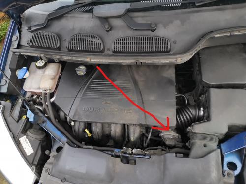

Thanks for the reply. I already bought the MAF cleaner and want to try this inexpensive option first since I bought the car really cheap for work purposes. Here is a pic of the engine bay, usually the sensor is on the intake hose or somewhere around there, but in this car I can't see anything.
Is this what I'm looking for?
Yep that's it mate
So this is the throttle body. MAF is located in the front of the engine between the engine and the radiator. It's pretty hard to reach in this model of car. Need to remove radiator fan to get access. Or lift the car up and you might get better luck.
