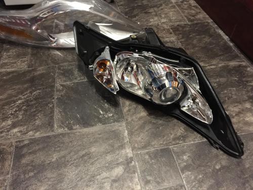

Does anyone know the best way how to remove the headlight lens? Every time it rains (I live in Manchester) my headlights are full of water, I tried to silicone them twice but now I want to remove the lens to do it right. To make it worse I've just snapped one of the taps on the bulb covers aggggh.
have you thought about drilling a small hole in the bottom of the unit
Did think of that but just wondered if anyone had removed one as I could give em a good clean at the same time
seen it done with a heat gun but you have to be careful
I had this on my '57 Mondeo. I had to remove the bulb cover and put a hairdryer with a hose on it in the hole to dry out the lens. I then got some clear silicon sealant and went around the original sealant beading at the top of the lens and down the sides as far as I could. This resolved it. Hope it helps.
The near side was bad but the far side was so bad there was gold fish inside!! Seen some videos on youtube (no Mondeo ones) and Jimmy BB tried it with great results, but took that long last night to remove the lenses(being careful) I left the silicone in until today....bad mistake! Two cut hand later there ready for tomorrow when the black RTV silicone sealant arrives via Amazon and I was trying to work out how to put weight on em but just thought....I'll cable tie it to death. I've Silicone the light twice before (that's why it took so long last night) checked the bulb covers and still leaked. Off to Chester later this week to have the ECU remapped and thinking about having the DPF and EGR delete but you can buy the EGR blanker plate on eBay for £4 so might just go for that, should be a beast by weekend now shes nearly a teenager!
