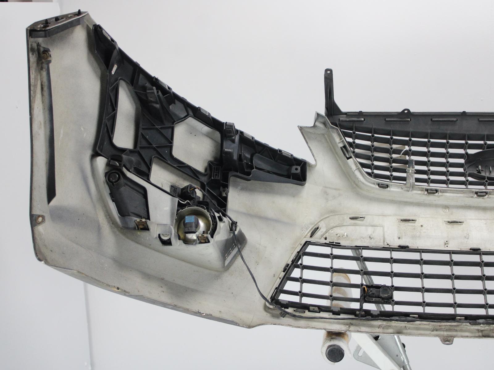

Sensor above fog light:
FORD MONDEO MK4 FRONT BUMPER WITH PARKING SENSORS PDC SEA GREY 2007-2011  - Picture 10 of 11

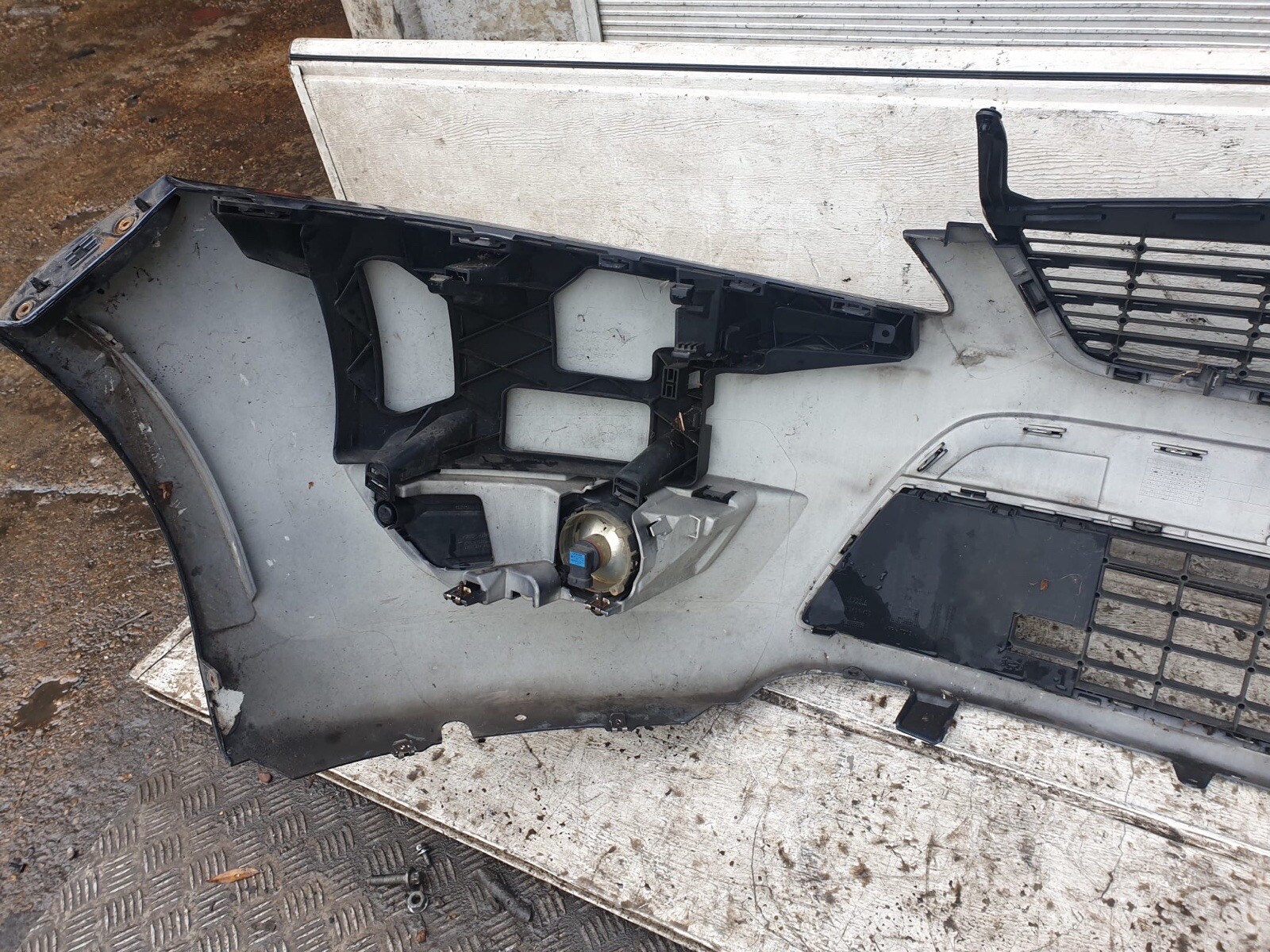

No sensor fitted:
Ford mondeo BUMPER 2008 MONDEO GHIA BUMPER WITH FOG LIGHTS DARK GREY COLOUR - Picture 15 of 16
However, there is an additional bracket plastic-welded on to factory bumpers for the outer sensors.  Parts list doesn't give a part number for this, so may not be available new.  Hopefully they're salvageable from your old bumper.
