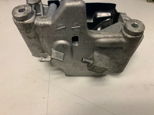

If you do want to refit it, it just pushes on to a small nipple on the bottom of the filter housing.  I don't know what the visibility or access is like on the Edge.
Ford Focus Fuel Filter Housing Mount 2.0 Diesel ST250 2015-2018 1872137 - Picture 7 of 7
Thank you Tom, its not an important hose then, II think I will leave mine off as it seems to be a bit fiddley to refit
