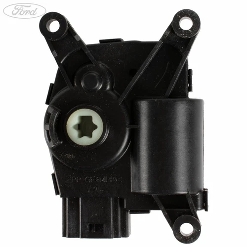

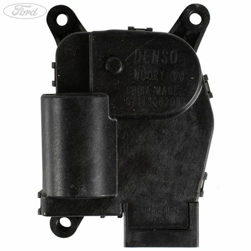

If it does light up, then the direction flap isn't being moved inside the HVAC box.  It may be a separate flap to face/screen vents.  The flaps are driven by small actuators like this.
Genuine Ford KA MK2 Heater Actuator Auto Air-Con 2008-Onwards 1751262 | eBay
Genuine Ford KA MK2 Heater Actuator Auto Air-Con 2008-Onwards 1751262 - Picture 3 of 4
Genuine Ford KA MK2 Heater Actuator Auto Air-Con 2008-Onwards 1751262 - Picture 4 of 4
