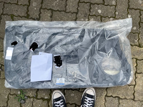

Couldn't find anything other than this item, which I'm unsure as to whether this is actually the damper
pad or something else?
NEW GENUINE FORD FIESTA MK8 FRONT PASSENGER DOOR LINING SEAL 3DR 2012-2018 | eBay
NEW GENUINE FORD FIESTA MK8 FRONT PASSENGER DOOR LINING SEAL 3DR 2012-2018 - Picture 1 of 3
I don't think anyone could accidentally leave that whole panel off.

I think that what you have posted is the inner door seal that goes under the door card, to prevent water getting into the car.
