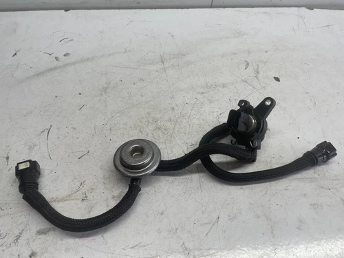

There is a common part that leaks on these.  It's a small round metal part in the middle of the fuel pipework at the top.  Only available as part of the pipework and costs around £180 from a Ford dealer.
FORD FIESTA FUEL PIPE PUMP TO FILTER 1.5 DIESEL MK7 2012 - 2017 FM5Q-9D350-AA - Picture 1 of 10

Good instincts and thanks for responding!  I've managed to find the leak (at the top of the engine at the back, not half-way up) and I think it's the part you've shown in your picture.  (See picture of mine below).  It seems to be leaking from the bit I'm holding in my hand( black plastic bit on right of your picture).
What is this part called?  Is ebay a good place to get it?
Yes I think that's the same part.
Part number is 1918296.  Though I would double check with any seller before buying.
If you want a new one Arnold Clark have an offer on through their eBay shop using a discount code.
https://www.ebay.co.uk/itm/256049137633?
I'm not so keen on buying a used one as they break so frequently, a used one may not have long left.  Though they are obviously much cheaper so that's your choice to make.
