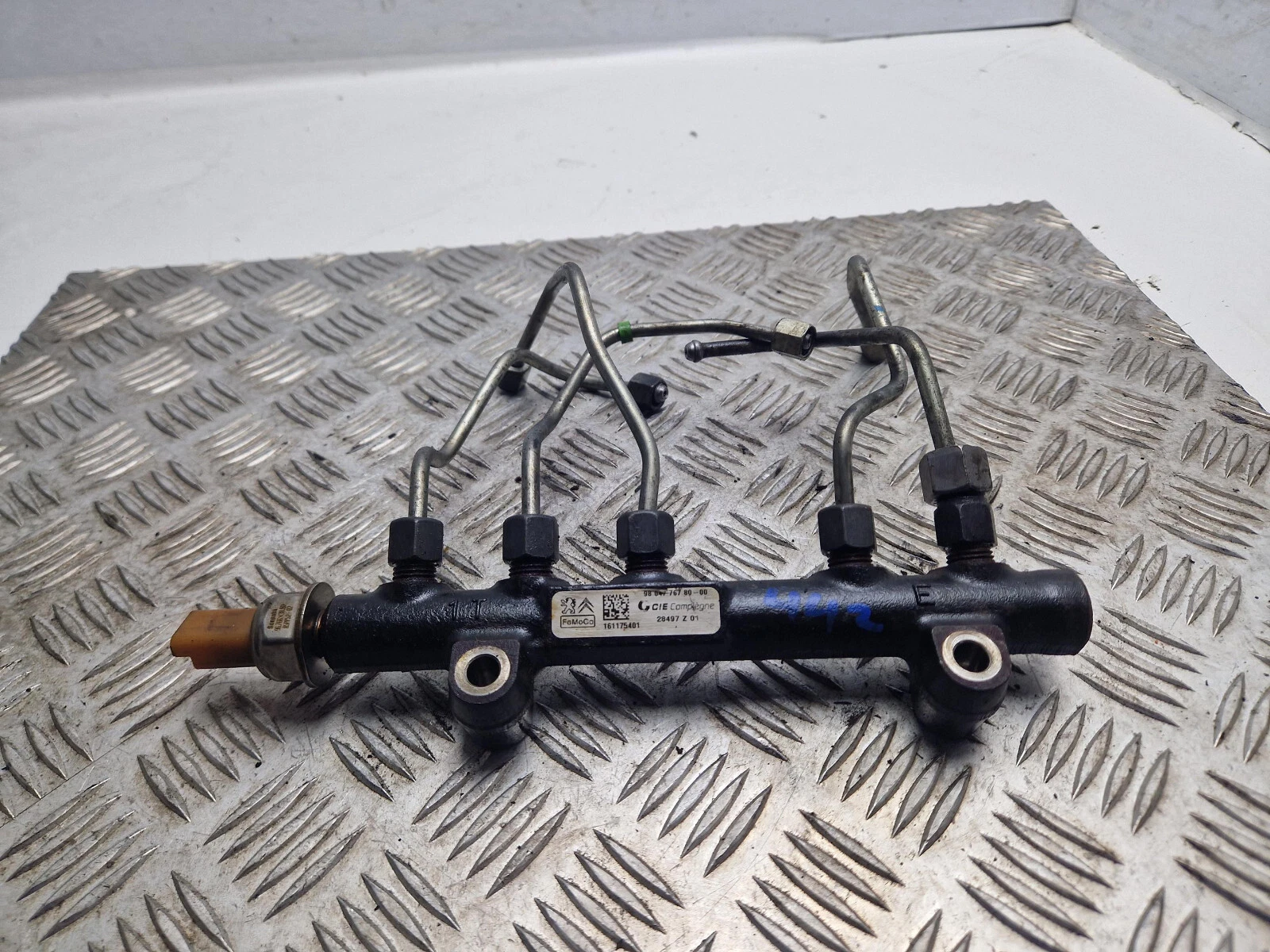

The fuel rail is behind the engine, about half way down.  Can't see it on that picture, or from the engine bay at all.
If you find the injectors then you can follow one of the hard metal fuel pipes back to the rail.

The rail is much lower down than that.  You can just see one of the hard injector pipes bottom right corner of that picture.  Follow that down to the rail.  The sensor is at the very end of the rail as seen on this picture.

can see the fuel rail but can’t see no sensor
It'll be on the rail somewhere.  Might be underneath if it's not at the end.  Feel around for it.  Will be the same shape as the one above.
