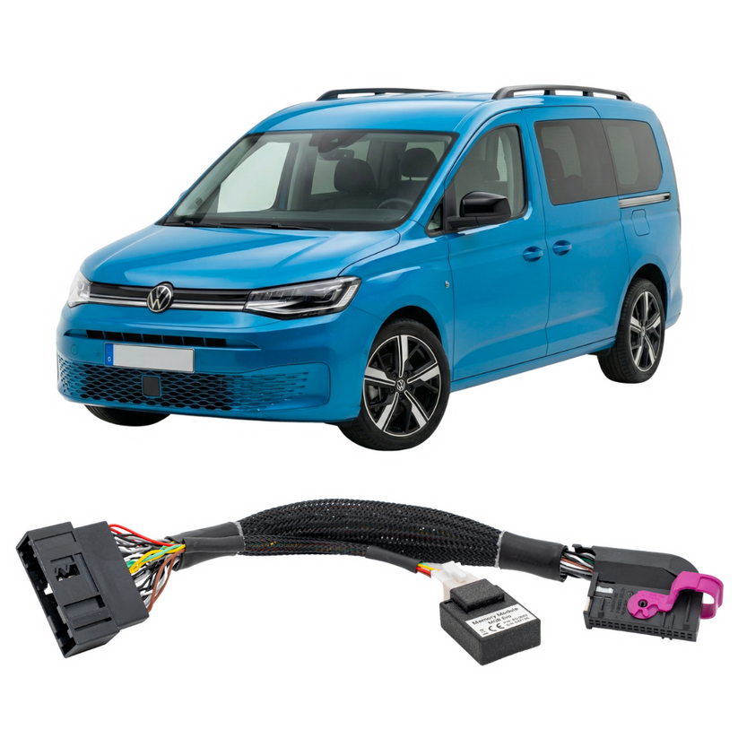

On the latest generation VW Caddy the Start/Stop system can be disabled in 2 different ways:
Temporarily by changing the setting in the infotainment system menu.
Permanently by installing a memory module:
vw-caddy-mk5-memory-module-391166.png?v=
The memory module stores the Start/Stop setting. Instead of enabling the Start/Stop system every ignition cycle it just remembers the last setting.
This should also work on a 2025 (Grand) Tourneo Connect as long as Ford did not do massive changes to the VW software.
Another possibility is to build a microprocessor with CANbus connectivity that sets the Start/Stop system to disabled every time the ignition is switched on. I have done this before on other vehicles that do not allow to disable the Start/Stop system permanently like for example the Focus MK4.5.
