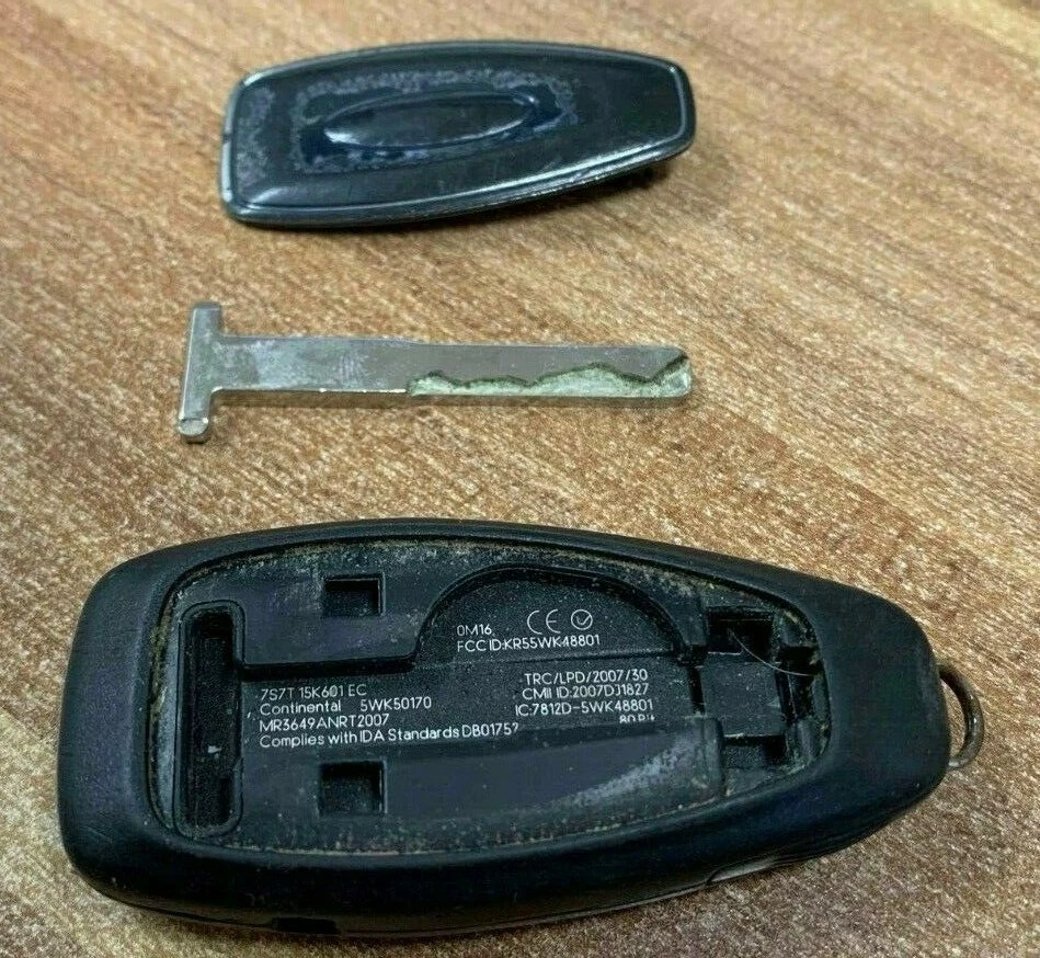

I've just found this picture on ebay showing the writing I meant. Though I must admit I can't see the chip ID now anyway.
GENUINE FORD MONDEO FOCUS KUGA C-MAX ETC KEYLESS SMART REMOTE PROXIMITY KEY FOB  - Picture 2 of 2
Agree to get the description shown inside the fob and ask any supplier which one is required?
Is the chip on the one above IC78(12D)?
