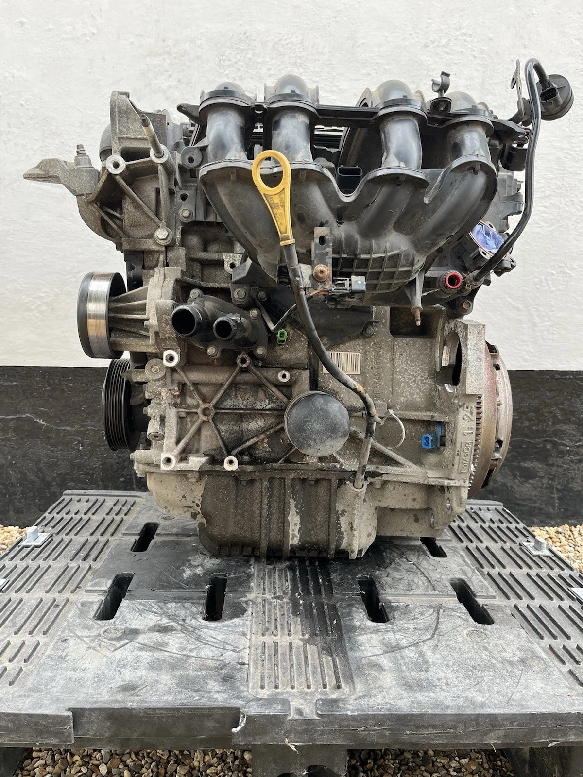

Hi, can anyone please advise where the oil pressure sensor is located on my engine. The 1.25 zetec ( duratec ) fiesta.
I'm looking all around the oil filer area for a green plug, but cannot find it anywhere??

It's higher up than you think. Same height as the thermostat housing.

Great, thanks for the help. Found it , swapped & cured the fault. Was leaking oil into the connector. Fault was intermittent " low oil pressure " on screen warning.
