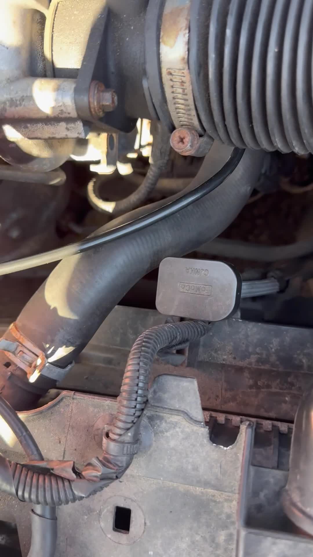

I done few more things, is this normal. When I rev at 2000 rpm, the coolant tank has two small pipes, the lower pipe is pushing some gas or air while the top pipe to the coolant tank is very hot. The coolant temp is 60 and radiator hose pipe is cold.
Could this be head gasket?

The thermostat doesn't open until 82c. So the radiator and top hose should be cold if coolant temp is only 60c.
Not sure about that small hose. Can't remember where that one connects at the other end. It could just be normal circulation. Coolant level is also low which may make it look worse. Should be on the seam of the tank or even a little over that.
If you want to prove whether it is the headgasket or a crack in the engine then use a CO2 sniff tester on the coolant. You can buy them cheaply online, or if you have a trusted local garage, they might test it for free for you.
