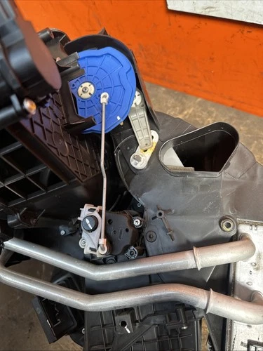

I can't tell whether the rod is still connected or not? It should look like this.

Rod is loose. Ah lucky I am, if you could call all of the parts I need fixing to be lucky lol!
I'll see if I can coax the rod back on and see if that fixes the problem.
Got the plastic thing back on despite the hot pipes down there being a pain.
Don't think it'll stay long term and will probably wiggle off.
