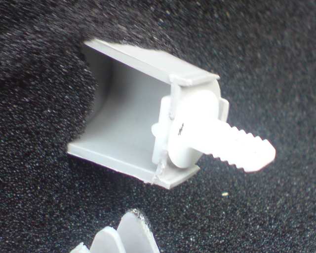

Trying to hunt down a creak/rattle I've had for a while now I took the plunge removing the passenger side A-pillar trim and of course managed to break several of the plastic clips in the process :rolleyes:
To try and fix the new squeaks caused by refitting the trim with half-broken clips I ordered a handful of new parts from local Ford dealer. The new parts are quite a bit different and I nearly rejected them as being the wrong ones till I took a closer look.
Old clips looked like this
while the new parts are these
So apart from the colour being different (which I can live with) the base of the clip is much larger. I'm guessing they have been changed to make them more robust - has anybody fitted these to their cars? have to wonder if they'll actually fit into the clip locator on the trim without getting the stanley knife out :unsure:

I think a bit of trimming will be needed.
Yep, 1 was ok but the other 2 needed trimming down as there are some ridges on the clip retainers that the bigger base fouls.
Thinking on I could have removed the ridges instead but don't think it matters really.

Back to the original subject with this post - got the black trim pins fitted now on the a-pillar trim and they are a massive improvement compared to the old ones. Have removed the trim several times now and it pulls away easier plus the clips don't break.
