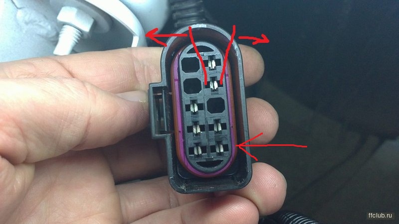

If you mean the tang on the connector you have to push over to try and release it from the headlight I've had that happen too - it's not the best of designs.
The connector will probably stay secure without the retaining tang, with my last Focus I did replace it as I was able to source a spare housing from work then had to de-pin the damaged connector and fit the new one to the loom. There's a purple/pink clip you need to pull out of the side of the connector before you can get the pins out.
The housings cost next to nothing if you are able to find them online, but Ford dealers may charge a premium :(

To get mine off after the tang broke I had to butcher the connector with a soldering iron while it was still attached to the headlamp. Still got the remains of it but can't see any details - googling shows the connector is also used on Jag X-type, ST170 and some Skoda's too.
up25737-up169902_13102011627_1318578918-
It's a lot easier to source a replacement connector if you've got the manufacturers name and part number - will see what I can dig out for it.
