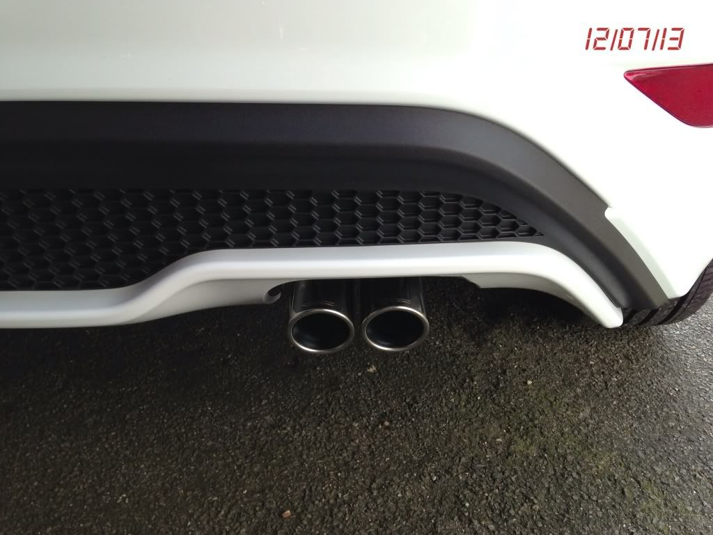

Any scope for cutting off the angled down standard exhaust outlet and fitting a more suitable looking tailpipe (plus 90 degree pipe section if needed) which outlets to the ST bumper cut-out? These often simply clamp
Maybe lot simpler than changing the whole system and cheaper too.
Example here so you can see what I mean
FD026TAILS.jpg?240,240,0,0,80,16777215,1
I cut this part off-
Then got this from Halfords -
& finally pushed it on the cut down exhaust & clamped it on -
End result -

thanks for the pics, tbh should be similiar along the lines even though its a mk7. does it sound louder though in a good way though?

Changing tailpipe alone shouldn't sound any different at all.

No difrence to the sound at all, as its the boxes that affect that & I only cut a bit off the tail pipe after it exited the back box.
